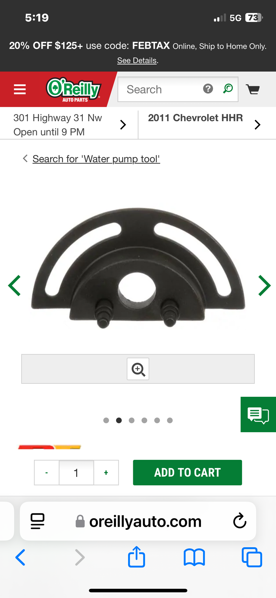

I used this style sprocket holder tool
https://www.astrotools.com/product/g...-holding-tool/
Old Feb 10, 2025 | 04:14 PM
Gearhead1's Avatar
Joined: 04-27-2021
Posts: 570
If you dont use tool like Oldblue suggested and use the half-moon type like I bought….make sure the dia. of it fits timing cover bore tight (mine had to must slack….and shim the face out so fits against the gear with no slack when tightened)..,.do yourself big favor and stuff clean rag in there so not possible to drop waterpump gear bolt in the engine.
Old Feb 10, 2025 | 04:23 PM
Gearhead1's Avatar
Joined: 04-27-2021
Posts: 570
Mine was like this…before I added to it.
Had I know better at the time I would have bought the full circle type
Had I know better at the time I would have bought the full circle type. And I had to get longer bolts after 1/2” plastic shim added to face of it
