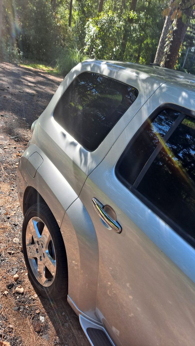

Hi everyone. Was wondering if anyone could point me in the direction of a replacement for the weatherstripping/rain insulation for the rear quarter panel where the roof meets the back side windows? Mine are currently crumbling apart and I'm afraid leaks are on the horizon.

I’ve not seen any reference to that weatherstripping or part number, I wonder if seam sealer could be used

Are you referring to the vertical piece that your thumb is touching in the pic? Or the horizontal piece along the roofline, from the rear door to the hatch?

Isn't that the door seal?

Looks like the door gasket to me. I guess checking with GM is out of the question. Maybe, stop by the biggest body shop in your area and ask the insurance adjuster where they would get it from.

Right
Door Opening Trim (Upper)
Part Number: 20787330
Supersession(s): 15909615
Old Sep 26, 2022 | 08:40 PM
RJ_RS_SS_350's Avatar
Joined: 05-01-2014
Posts: 8,513
From: California
Left
Part Number: 20787331
Supersession(s): 15909616
Old Sep 26, 2022 | 08:41 PM
Joined: 05-01-2014
Posts: 8,513
From: California
Right lower
Door Opening Trim (Lower)
Part Number: 15291984
Supersession(s): 22735910
Old Sep 26, 2022 | 08:42 PM
Joined: 05-01-2014
Posts: 8,513
From: California
Left lower
Part Number: 15291983

But the OP is asking about the weather stripping above the 1/4 panel to the roof.
