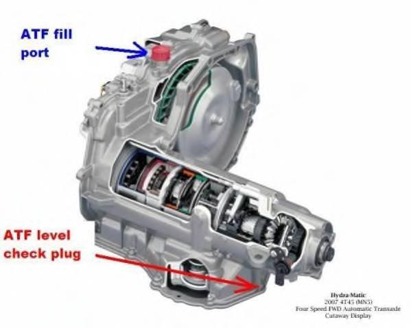

From what I know its difficult to do on these cars. Have to fill through the check plug underneath. So im just gunna give it to the dealer. As far as your fuel system it never hurts to do it but personally id wait till you get the 100,000 mile service and do it with the new spark plugs. Any issues with the car?

You can do the transmission service yourself, its a bit of a pain, but the info you need is in this thread.
https://www.chevyhhr.net/forums/maintenance-upkeep-50/checking-changing-transmission-fluid-28917/
