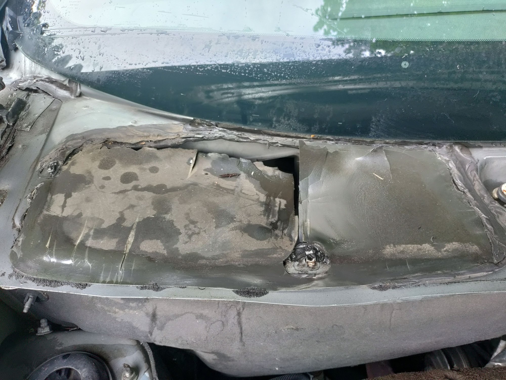

Found the problem, lol. Wasn't expecting it to be torn so bad

Nasty looking!

It was repaired in the past. Most just cut a piece of sheet metal or plastic and RTV it on.

Your photo explains why the cowl wasn't fitting well.
I used aluminun tape to repair mine

Get a sheet of rubber at the hardware store, rtv'd it on. While I was at it, cleaned a handful or two of leaves and debris out the area under the patch. While I was at it, I checked my wiring loom boot, but it was tight and in good shape. Thanks all for the tips and links 🙂

That was a hack job they did prior. That's why it blew again.

BTW, the patch is needed on 2006 an very early 2007 models ONLY. If you have a later model don't do it.
