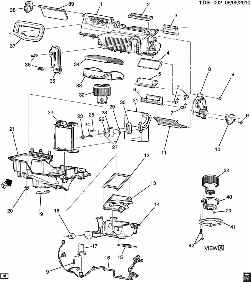

It's a blend door actuator on the driver side and I just replaced the lower one. I need to order the one above it but it has a different set of numbers than the one below it. Do you know the part number for the the blend door actuator I have circled? Also, can you tell me the part number for the actuator on the passenger side?

#8 is
HVAC Air Inlet Door Actuator
GM Part Number: 22724333
#10 is
HVAC Blend Door Actuator
GM Part Number: 10393075
#38 is
GM Part Number: 15842338

OUTSTANDING! I replaced 10393075 this afternoon, along with the power steering assist motor. If I'm seeing this correctly I'll need to remove 10393075 again to get to 22724333. Does that seem correct?
Old Mar 30, 2022 | 07:22 PM
Posts: 40,088
Yes , one is mounted on the other
