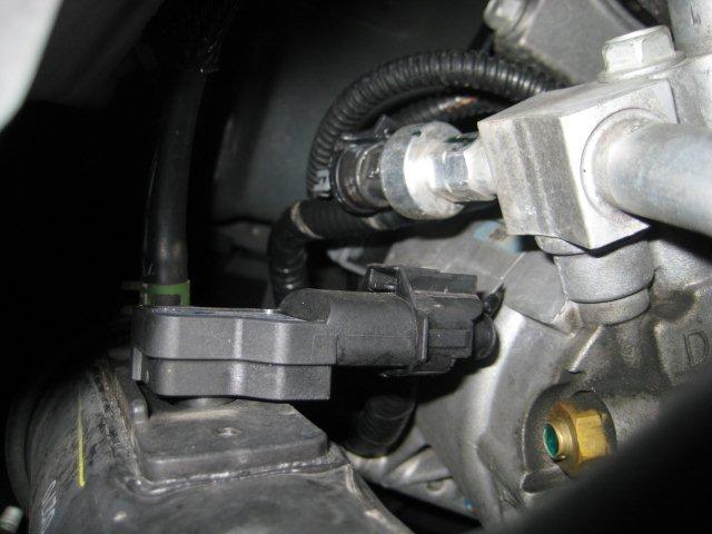

Is the car running in limp mode? When mine went into limp mode, 5psi was all the boost it could do. Acceleration was slow, but you could still drive at 80mph. You may have TMAP sensor problems. Try unplugging the upper TMAP while the engine is off and reconnecting it. Strange that you have no CEL or codes coming up. The lower TMAP is harder to see, but a small mirror or digital camera can show if something is going on down there like a dislodged sensor or abraded wiring near the A/C compressor contact area. I was having a weird problem and used my camera on the lower TMAP to find an issue. Dealer corrected mis-install and also replaced the crimp connections with soldered. Trouble free for 12+ months now. The symptom exhibited by the engine with the sensor like this was that it ran normal when driving normally, but when you got on it it screwed up because the charge pipe pressure was able to bypass the little o-ring while under boost and it messed up the sensor signal into the ECU and there was a loss of power. Why GM didn't orient the lower TMAP in line with the charge pipe and allowed the close spacing to the A/C compressor is a mystery.

Sidecardog1. Is that the Bosch t-map sensor with the GMTU kit? If so, looks like the tech didn't trim off the tab on the sensor.

Yes, that is exactly what happened. I had a sensor go bad and the dealer ordered and installed a new one (yes, it is the GM power upgrade). Apparently when the new sensor came in it was without instructions, so the tech didn't pick up that the tab needed to be removed. As soon as I had the problem, I investigated and saw the condition in the picture that I took by holding my camera up under the bumper until I got the money shot. I brought the car back along with the instructions that I still had from the upgrade plus the photo. They fixed it quickly !
