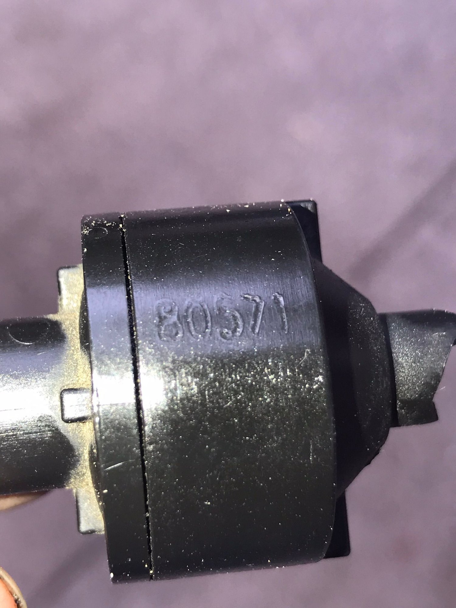

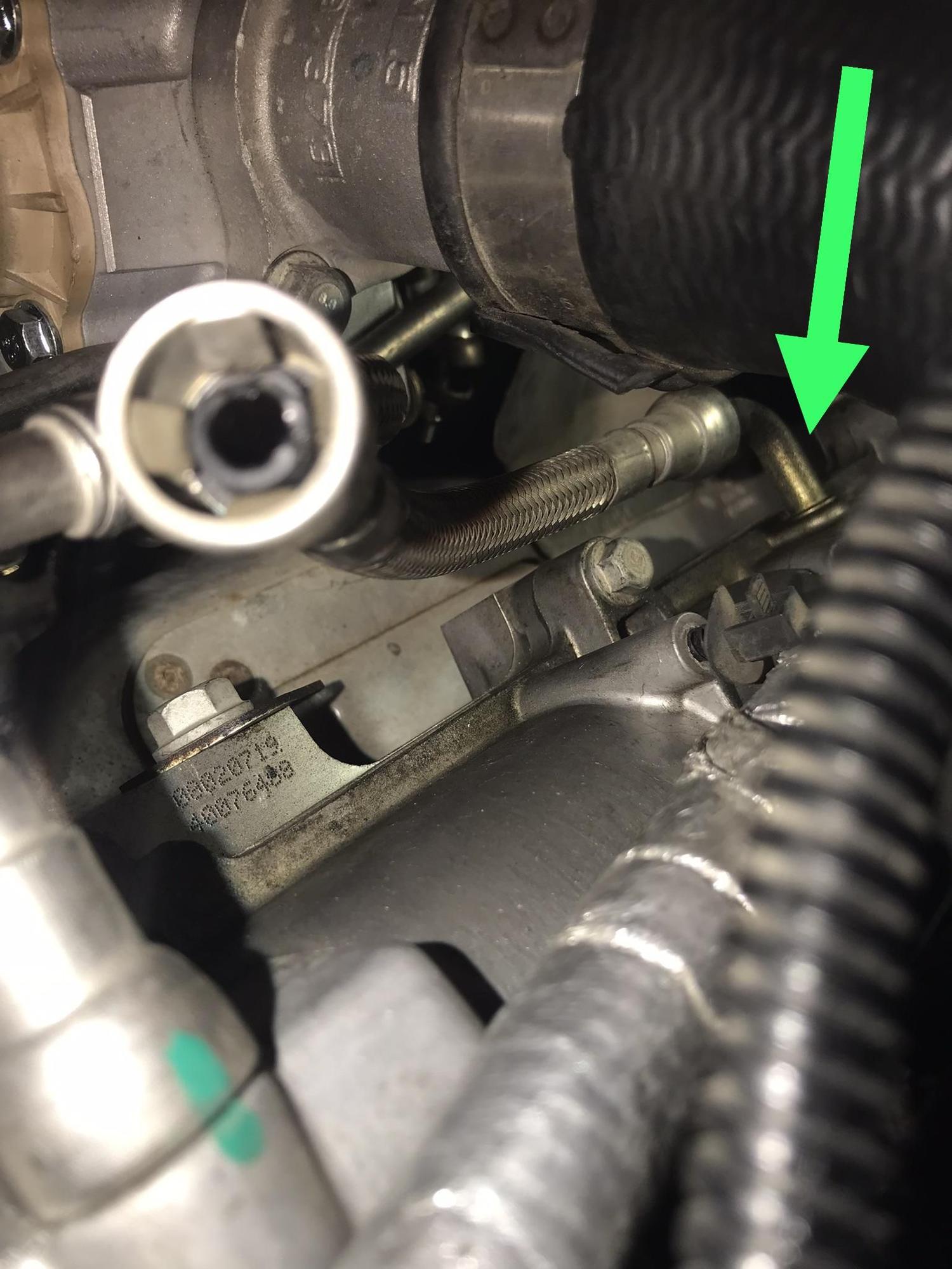

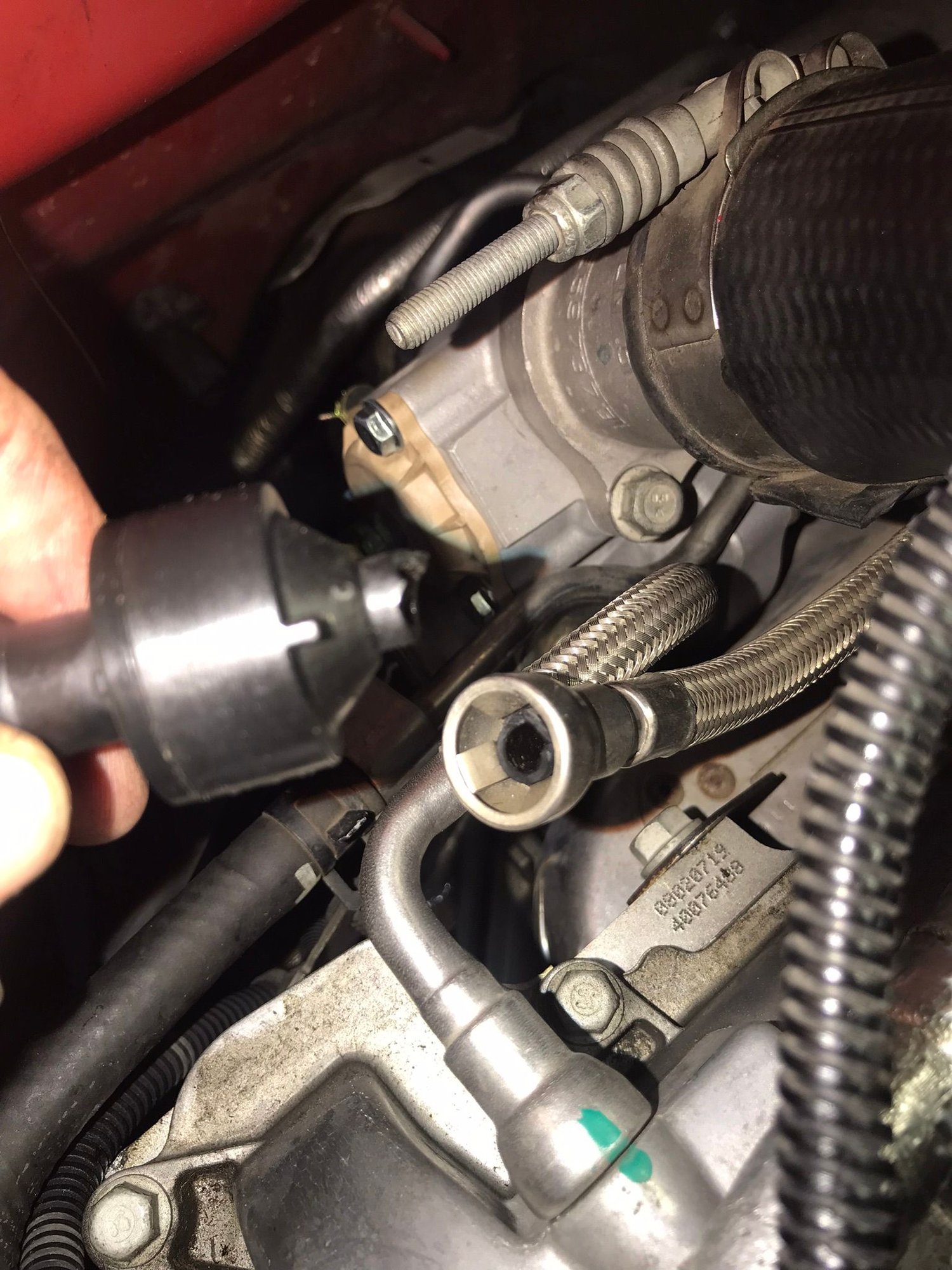

I broke this thing removing it from the intercooler tube. What is the black thing with the number 80571 stamped on it.. Also how do I remove the braided line from the valve cover?
Old Dec 13, 2024 | 05:47 PM
RJ_RS_SS_350's Avatar
Joined: 05-01-2014
Posts: 8,512
From: California
Not "the" PCV valve. It is the check valve for the fresh air inlet to the crankcase. It is part of the PCV system. It is part of the stainless hose, and no longer available. Here is my fix.
https://www.chevyhhr.net/forums/how-...et-hose-66754/
If you need to remove the other braided stainless hose, the one that goes down to the turbo, it cannot be removed with the fuel line tools Oldblue referenced above. You have to carefully cut the fitting off the valve cover. The other end at the turbo, is removable, there is a retaining plate bolted to the turbo. That line can also be replaced with the same size PCV hose that is in the link I gave.
