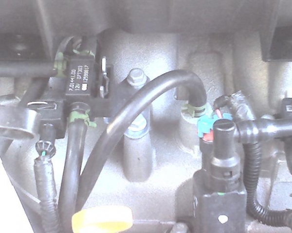

JSK, have a look at the bypass solenoid. It's mounted on the intake manifold, the component on the left in this picture
Make sure none of the nipples are broken or cracked, and that the wiring is in good condition.
There's another solenoid, looks similar, mounted to the turbo, just below the bypass valve. This is the wastegate control or boost control solenoid. This solenoid caused my P0234 overboost code. I replaced the solenoid, problem solved.
I still suspect your underboost problem is associated with the bypass valve, if it's not the solenoid itself, then it may be that in your rat's nest are the wires going to the solenoid. Maybe your mechanic or the dealer has the ability to test the solenoid.
I'm not sure if it could be the wastegate solenoid or wiring. If I'm not mistaken, the wastegate is normally closed, facilitating boost. As boost rises, the vacuum/pressure lines and/or the ECM (I'm not sure exactly how it works)will cause the wastegate to gradually open, to control boost. (my solenoid was faulty, so this was not occurring) As a failsafe, the ECM can trigger the p0234 code and command the wastegate to open (and stay open until the next key cycle), limiting boost to about 3PSI.
So if you're getting one solenoid tested, may as well test them both. And if you can determine that the wires to the solenoid are in that rat's nest, then you may be able to fix the problem right there.

Thanks, RJ - I did look and feel to make sure the solenoid down below on the turbo was in good shape - all the vacuum lines and plugs seemed solidly connected.
I've seen that bypass solenoid too - will double-check its connections and where those wires come from (as in: running through the Rat's Nest?).
Gosh I wish I had a multimeter (and knew how to use it) to test these components. I imagine the proper voltage specifications are in this forum's archives somewhere.
