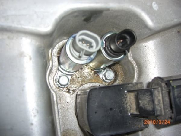

Actuators??? Did you really replace the VVT actuators, AKA “phasers,” or did you replace the solenoid valves, or the camshaft position sensors? A failure of any one of those would result in what should be recognized by the ECM as no or obviously bad data. I would love to know for sure how the RPD would respond in each case.
When I had the P0010 code for a bad intake actuator, this is how the RPD would show the intake side not working. The needle would just bottom out on zero on that side of the gauge. I never got got a "NO DATA" display. I think you'll only get a no data if something is unplugged or disconnected.
(I did replace both my solenoids. RPD gauge reads fine now )
That pic is exactly what I’m talking about. Great info.
Old Jun 27, 2022 | 09:22 AM
Posts: 40,083
Camshaft position sensor, located on driver’s side of the head, there’s another one on the exhaust side. Tells the computers what the camshaft degrees are
Camshaft actuator solenoids, controls oil flow to the camshaft phasers , which are bolted to the camshaft and driven by the timing chain
These are the phasers They all work together in the VVT system
Old Jun 27, 2022 | 11:27 AM
Posts: 26,533
Since the valves control the phasers the semantics get confused. "Valves" become "actuators" because the actuate things. "actuators" becomes "solenoids" because they change states. To be factual a "solenoid" is the electrical part of the VVT valve assembly. Mechanics and parts guys aren't smart enough or don't take the time to understand what books say.
But the pix Oldblue posted are the correct nomenclature.
