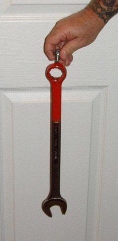

  #46
Magnetic Drain Plugs are not created Equal..
I tested the local auto parts magnetic drain plug, the magnet would not even pick up a 1/8" wrench.. Not impressed.
Well, then got one with a Rare Earth magnet. It will draw nuts & bolts across my work bench to it... And will hold a 1- 5/16" combo wrench.. That's a worthy magnet..
https://www.chevyhhr.net/forums/show...665#post456665
