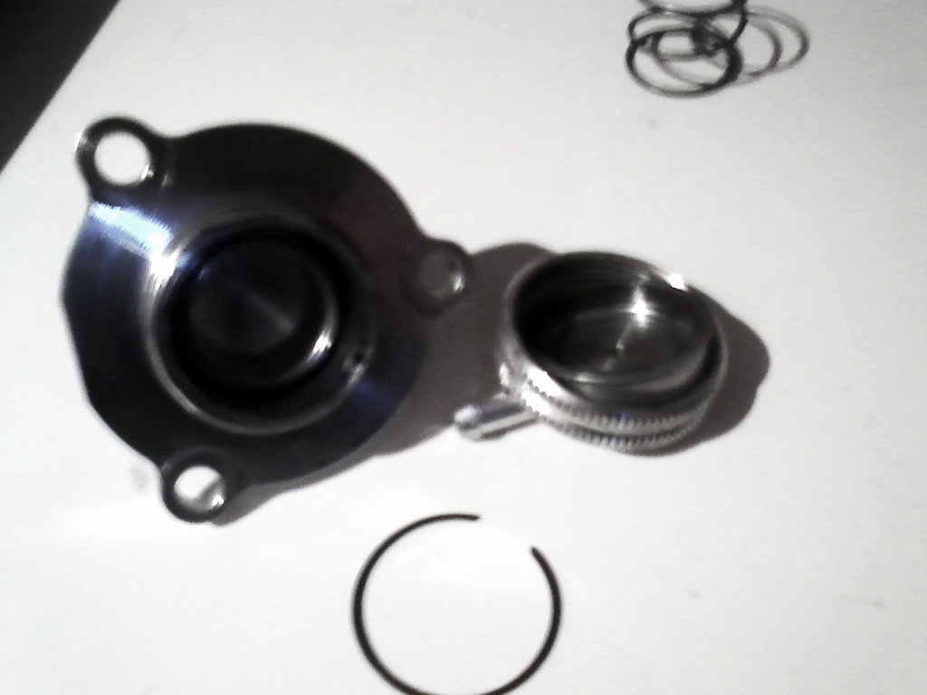

Heres a pic the forge it will not hold vacuum when I do the test (push the piston in and cover the nipple hole then piston will just fall back rather than staying in place). This gasket goes between the cap and BPV, its broke or missing a little piece.

You can probably find that O-ring at your local auto parts store.

Yea i put the stocker back in for now did about 5+ pulls today and plugged in my tuner and no codes as of right now. I emailed forge and asked for a rebuild kit. I think my green spring is junk cause I tested the forge today and it passed with the yellow spring but failed with the green spring.
