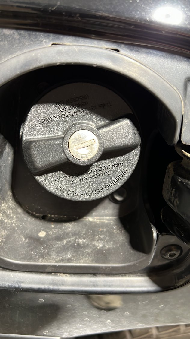

as I checked my fuel cap seems to be some old china cap from the owner before me. Maybe that’s the thing

haven’t noticed any whistles more than there should be but when I’m back I have to check for leak probably. In my other answer I said I saw my fuel cap is some Chinese crap.

Fuel cap has nothing to do with the codes cited.

P2187 for an HHR has nothing to do with gas cap, that would trigger EVAP codes. Generic code descriptions are OK, if you take them with a grain of salt.
