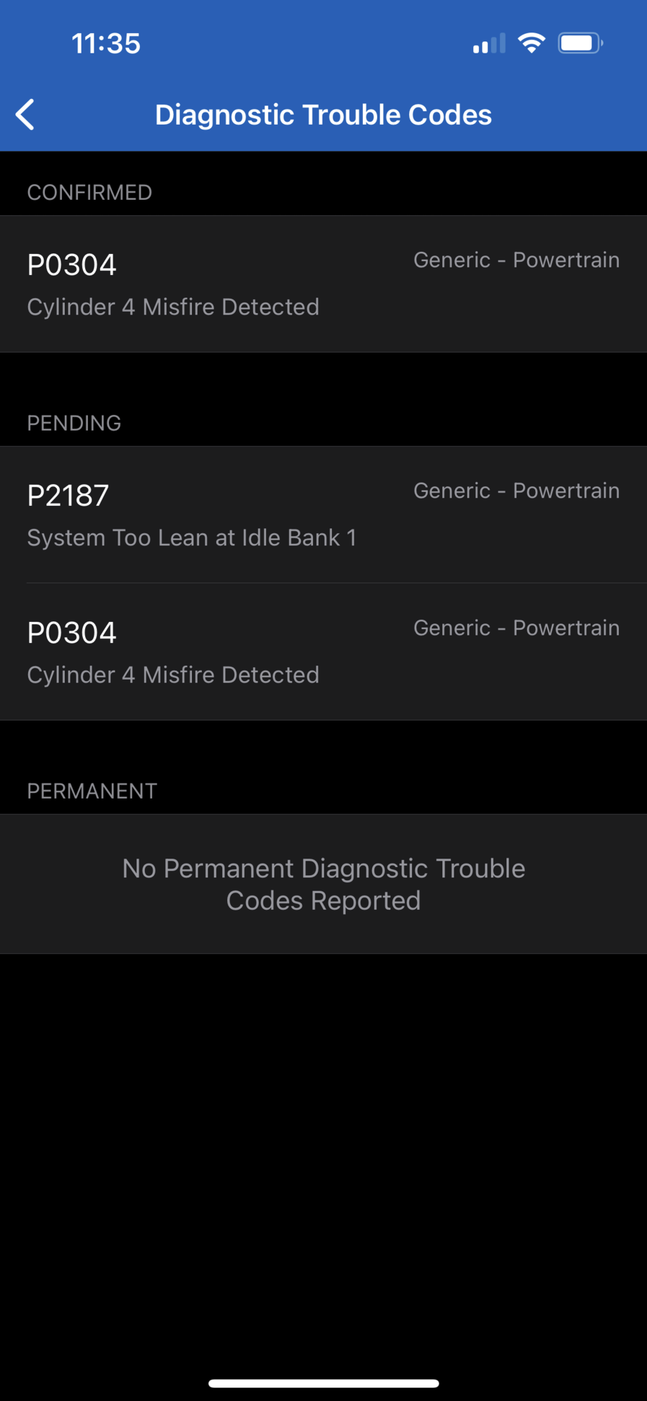

Originally Posted by greg8453
Has it learned idle?
Now I have these again

Posts: 26,533
Have you:
cleaned the throttle body?
Checked the engine coolant temp?
done a compression test?
Cleaned the fuel rail?
Checked both fuel pressures?
Checked the EVAP purge valve?
The misfire is probably causing the P2187.

RJ_RS_SS_350's Avatar
Joined: 05-01-2014
Posts: 8,512
From: California
Cleaning the throttle body is a bit of a job on the LNF, as is cleaning the fuel rail. I would start with donbrew's other suggestions first.
I don't see that you've mentioned how many miles are on the car. The intake valves might be coked. The compression test would be the first step in diagnosing that, followed by a cylinder leak down test.

Originally Posted by donbrew
Have you:
thank you!! Lots of things to try for me then
