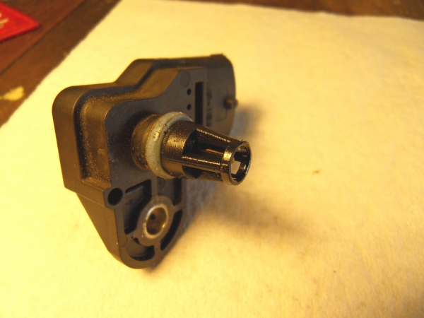

Oil level should be OK; I recently changed the oil but will check anyway. Haven't checked MAP sensor for oil; I'll do that today. I believe you're right about the slight incline and low boost when the stumble and loss of boost occurred. I was just cruising along maintaining 65-70 MPH just before my exit. That slight incline was right after a slight decline. So, How is the incline/low-boost related to the problem? Any insight much appreciated...

My oil level is good, but I will check my upper map sensor for oil. I know my lower wiring is good as I checked it thoroughly. The latest problem was at steady highway speed making about 1psi of boost. Is this relating to the upper map sensor covered in oil?

Well I cut out the old solder joints, and re soldered and heat shrinked the wires. ground the tab down and turned the sensor around. Cleaned both map sensors, although both looked very clean already. I erased the pending dtc and reset the keep alive memory. I only put on 30kms today after and it seemed to run alright, time will tell as it is a intermittent problem.

The MAP sensor was pretty oily and dirty before I clean it on 2 Sep. Ran good for about 400 miles.
I thought the intake looked pretty clean on 2 Sep. There appeared to be a slight film of oil from what I could see through the opening where the MAP sensor goes but nothing alarming to me.

UPDATE (24 Sep): Checked upper MAP sensor--looked cleaned and oil free, but cleaned anyway. Cleaned MAF sensor. Rerouted lower MAP sensor wiring. Ran like a rocket during test drive--easily produced over 15 lbs boost just rolling into 1/2-3/4 throttle like it should all the time. We'll see how long it takes before the boost goes flat...again.
