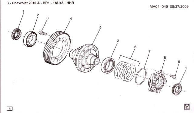

SS LSD Exploded Diagram
I have the 2010 HHRss with the manual transmission. Note that there are two manual transmissions, one for the SS and one for the non SS. The differential for the non SS is rebuildable, the one for the SS is replaced as a unit. The attached exploded parts diagram shows the clutch plates for the LSD. A small amount of slip is allowed and then the LSD will lock up the two drive wheels. I got this from the dealer parts guy. I gave him my VIN and he printed out the attached. This is my first attempt at attaching something, so I hope the diagram shows up !
