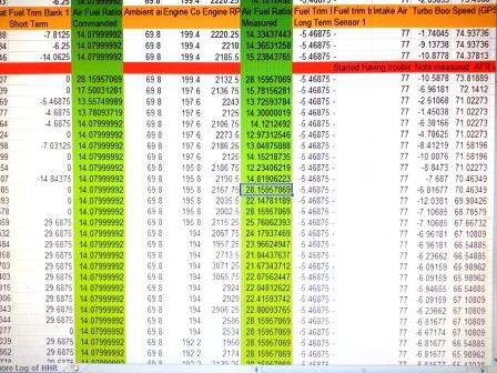

Here is a shot of when it is running rough going into limp mode
[attach][attach]Name:  condensed screenshot 7-15-1320130715_104918.jpg
Size:  47.7 KB[/attach][/attach]

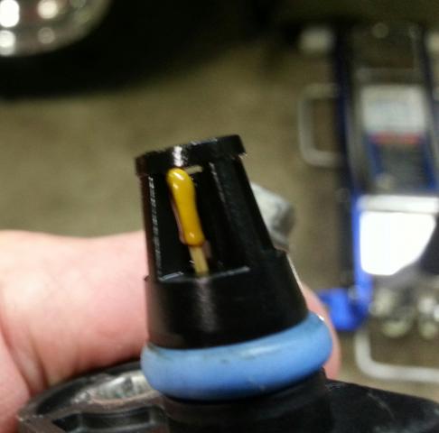

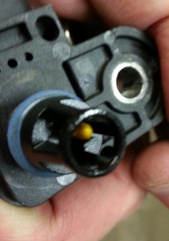

the other 2 pics above are of the upper tmap sensor after it goes into its limp mode.
As others have suggested possible pcv issue
still looking for a pcv hose routing diagram with the add on electric vacuum pump
for the brakes

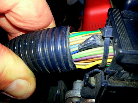

Here is a picture of the electrical tape that I found when I pulled the plastic covering back of the wires that go to the ecm
anyone know what these color wires (blue and gray) do.
I thought maybe they where in here when they added on the vacuum pump for the brakes but according to the instructions this is not the side they deal with.
