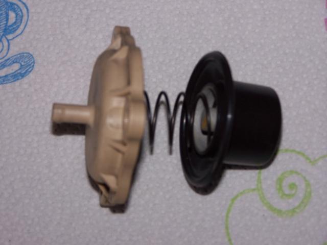

Here's a pic of my good old bv valve. If you'll look in my sig, you'll see I'm running the Forge valve. I think there's a few of us on this forum running the same valve.

It was more or less so you could compare yours to mine. If your spring is not as long as mine is in it's disassembled state, then you may have a weak or "sprung" spring.
The picture was just for comparison purposes.
