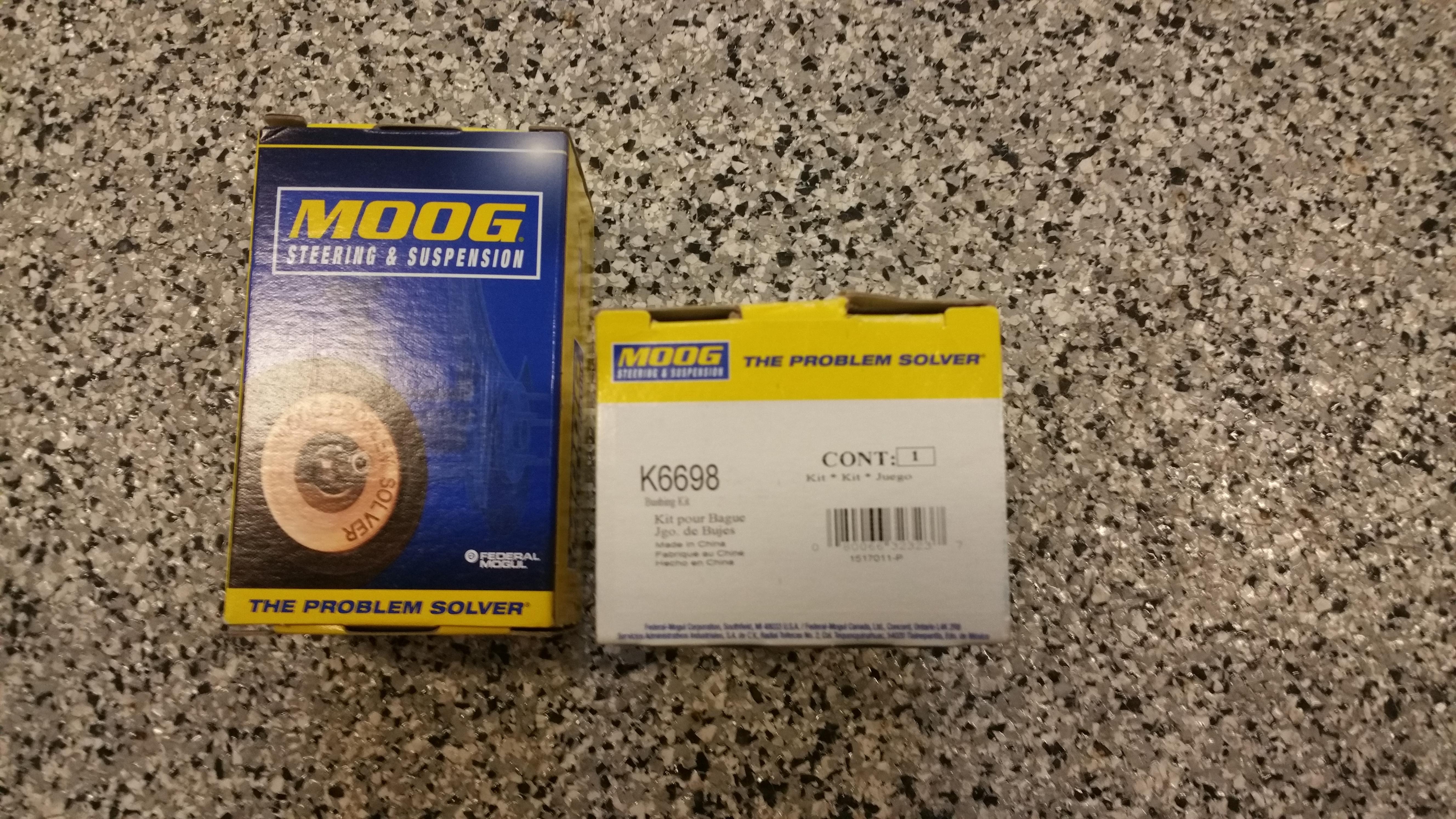

I just wanted to make a thread stating that the Moog 6698 does work in our cars, and does tighten up the feel of the front end. I was searching and couldn't find much info on it, so just adding it for future searchers.
Originals lasted about 70k, I would think these would outlast them by a considerable margin and cost less than $9 each.
