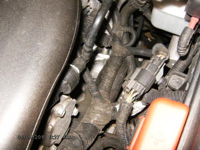

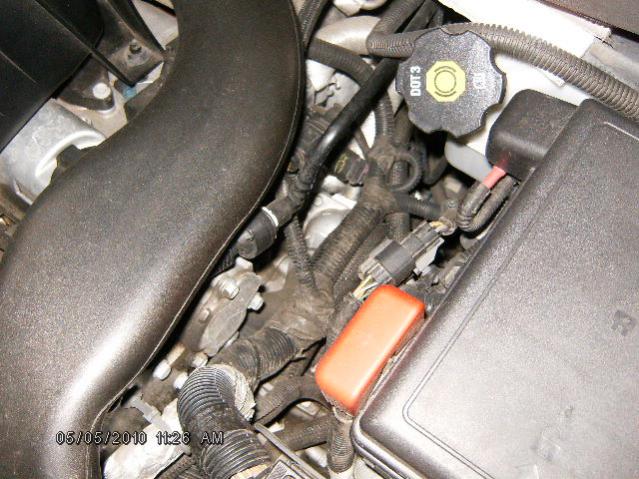

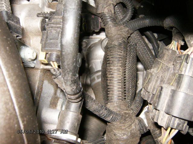

Thanks for the pics
Mines practically hidden by tons of wire bunndles.

Looks like a PITA to change and probably worse on the SS, but that's best place to start if your running at higher temp with no coolant loss. I would be surprised if T-stat is covered, but dont hurt to ask..

Ya upon a closer look . It apears to be under 90% of the wiring in the engine bay, Nice.

Definitely more buried than I thought it would be. Is it in the same location on the SS? Shouldn't be too bad once you get a couple of extension bars on the end of a ratchet. Best to do it when COLD!! and after you drain it. It's going to make a bit of a mess, so be prepared for some cleanup.

Guess that answers my question. They are usually pretty cheap...<$10. Not to mention that a fluid change isn't necessarily a bad thing.
