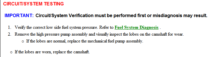

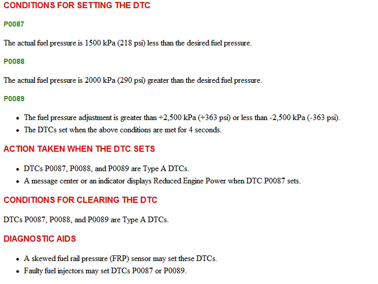

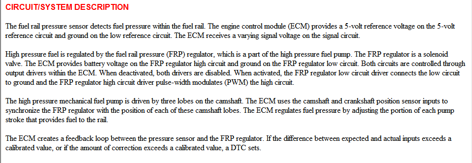

The thing is the HPFP is mechanical, BUT it has electrical controls for varying the pressure. It runs off of 3 lobes on the camshaft the electronics control which lobes to use for the demanded fuel pressure.
As I said earlier the in tank pump should supply around 150 PSI not 70 PSI
