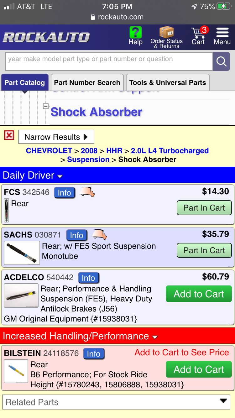

I found this assembly kit on rock auto but it has no FE3/5 rating info on it at all. And they have rear shocks listed in 3 categories with major price differences. Of course no FE info on the cheap grade.

The cheap set has no FE rating ( go figure) so I guess I would have to go with the Sachs unless someone has experience with those cheapos.

The Sachs rear shocks are OEM , so those are good
For the front either the KYB or these FE5 spec AC Delcos

GM ONLY for lower control arms when the time comes, RockAuto has them at the best price. You do need to use FE5 parts on the SS, as that is what is factory heavy duty compared to the FE1/3 stuff. Front struts, I put KYB on the front of my 08 SS and I'll be pulling them for Acdelco at tax time. An old post here had a member reach out to KYB about their struts for an SS, and they said directly they don't make a front strut for the SS.
you will want to get new top hats with the bearing, the metal plate that goes below it, and new insulators top and bottom of the spring. You shouldn't need to replace the front springs honestly, but they are on GMpartsdirect for less than 40 each. Rear shocks, zzp has the upgraded bilstein shocks for just a tiny bit more than the OE stuff on rock auto. It can be daunting, but due diligence when parts hunting for an SS will serve you well. I'm about 6 weeks into owning my 08 and have been doing the same!
