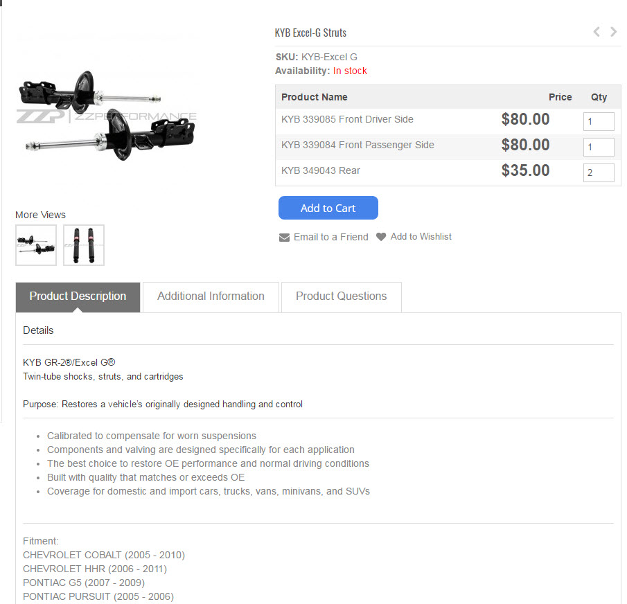

I found KYB struts (only) at ZZP and Summit - same prices, same part numbers but ZZP site doesn't show the HHR SS specifically, If I were to reuse the other pieces of the assembly (springs, bearings, etc.) would these work with the FE5?

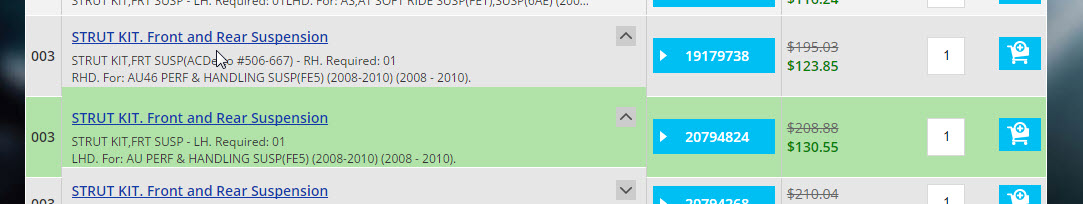

Showing my ignorance here but what the difference between FE 5 and FE5? The sticker in my glove compartment shows FE5 (no spaces).

No difference. FE5 is the SS only suspension. Oldblue just did a typo when he put a space in there.
What he's trying to say is. Don't believe a seller that claims their struts will replace the FE1, FE3 AND FE5. That's simply not true since the FE5 struts are different than the others.
(technically, the struts all bolt up with the same bolt pattern but the FE5's are stiffer for the performance suspension set up of the SS )
