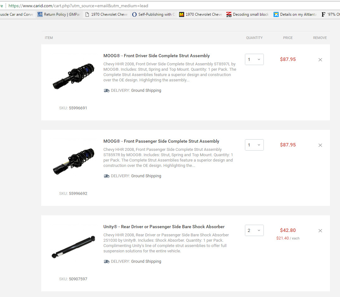

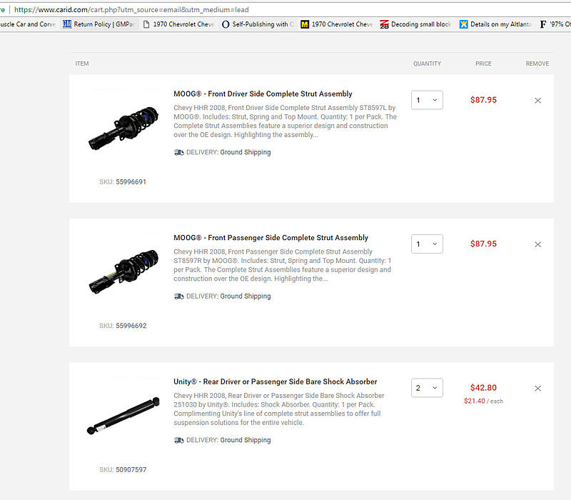

GM Parts Center strut kits are NOT KITS, bare struts, plus one strut was missing the nylon top nut. GM Parts Center wants 15% restocking fee PLUS return shipping at my expense - $55.00 via Fed-Ex even though they shipped UPS. Guess I'll live and learn - never buy parts from them again.
Found these complete struts at CarID for much less money and they're supposed to fit all models - anyone use them before?

With those Moogs you will be getting what you paid for. They are not SS specific, they will most likely fit great, but the spring and shock rates will not be to SS specs. and who knows how much higher the front of the ss will sit. Note they say they fit all models.
You really need to go back and read some of the earlier posts in this thread about the specifics of the FE5 suspension.

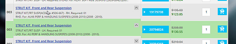

These are the only ones I think anyone has found that are SS specific:
FE5 Suspension (SS):
- GM: P/N 19179738 (right side) - P/N 20794824 (left side) - (from member andyb)
- AC DELCO: 506667 (right-side) - P/N 560581 (left side) - (from member sinabu)
