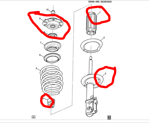

Posts: 26,533
You will need the circled parts at least. Most can be found much cheaper than GM.
I think 7 & 8 & 9 are part of the mount assembly. Maybe not.
