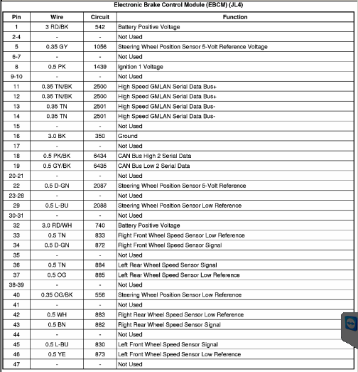

My AllData has one diagram that includes wires for LNF and -LNF. On the connector pinout it does show 2 5 volt refs and 2 low refs for steering angle sensor. You may not be seeing the GMLAN connection
Ok. I must have this diagram, but it is in a different location somewhere. It confirms that there is not supposed to be a steering position sensor. I don't have an ABS warning light and ABS appears to be working ok. My OBD interface needs to be upgraded to one that has SW CAN. So, I am working without knowing what code is set. But, I will buzz it out and find out what's going on with it.
