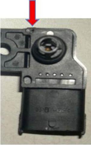

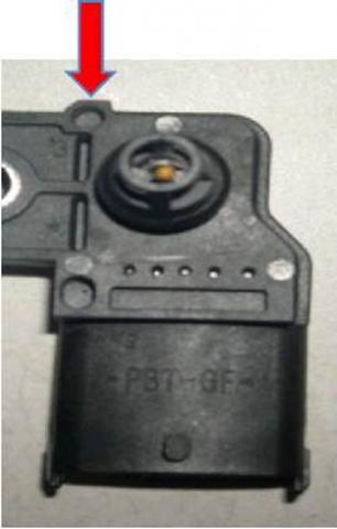

Removal of Lower TMAP Boss for Stage 1 Upgrade
Here's the before picture showing how the lower TMAP looks out of the box with the little boss on. Then the other picture shows the TMAP with the boss removed so that it can mount flush with the air pipe and seal properly. I used an extension mirror and a maglite from above to see that the TMAP was installed incorrectly. I would suggest that folks having trouble with the Stage 1 kit installs check out their lower TMAP mounting.

Thanks for the info. By the way, your ride sounds real nice! I'll be speaking with the folks at my dealership service area on Monday morning. They are nice folks there and will give me a demo car to use while they grind away the TMAP and reinstall correctly. I'll show them the above picture set and the page from the install instructions so there will be no reason to mess it up this time. Too bad we have to tell them about their product procedures and problems, but if we all learn from each other then maybe we'll all have less problems with our rides. I really love the boost from the Stage 1 kit, but hate the problems getting it right and the inconvenience that goes along with the repairs. If the connectors fail on me again, I'll try to coerce the dealership to solder them up. Somebody messed up with the lower TMAP orientation and the requirement for cutting into both upper & lower harness to splice in the different wires. Would have been much nicer if it was a plugged adapter pigtail that simply plugged in. More expensive yes, but I would have gladly paid more than to go through this type of BS. Whatever was GM thinking?!! Keep everyone aware of what the problems and solutions are.............

5spd with the performance pkg & Stage 1 upgrade kit. It was 5 psi in all gears that I tried 1,2 & 3 and to get that the gas pedal was all the way to the floor. It was repaired this morning (correctly installing the lower TMAP). Boost is 20psi +/- now and runs well. Dealer was good about it, apologetic, demo loaner so I could run and errand while they did the correction and I was back home quick. Tomorrow the car goes for a 250 mile roundtrip to St. Pete, so that should be a good test.
