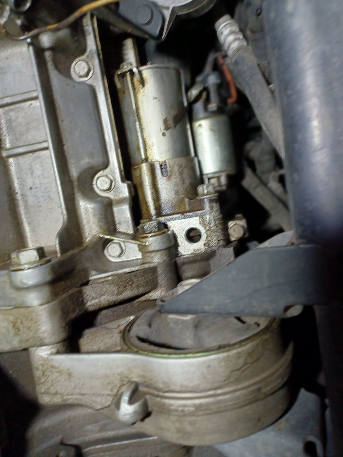

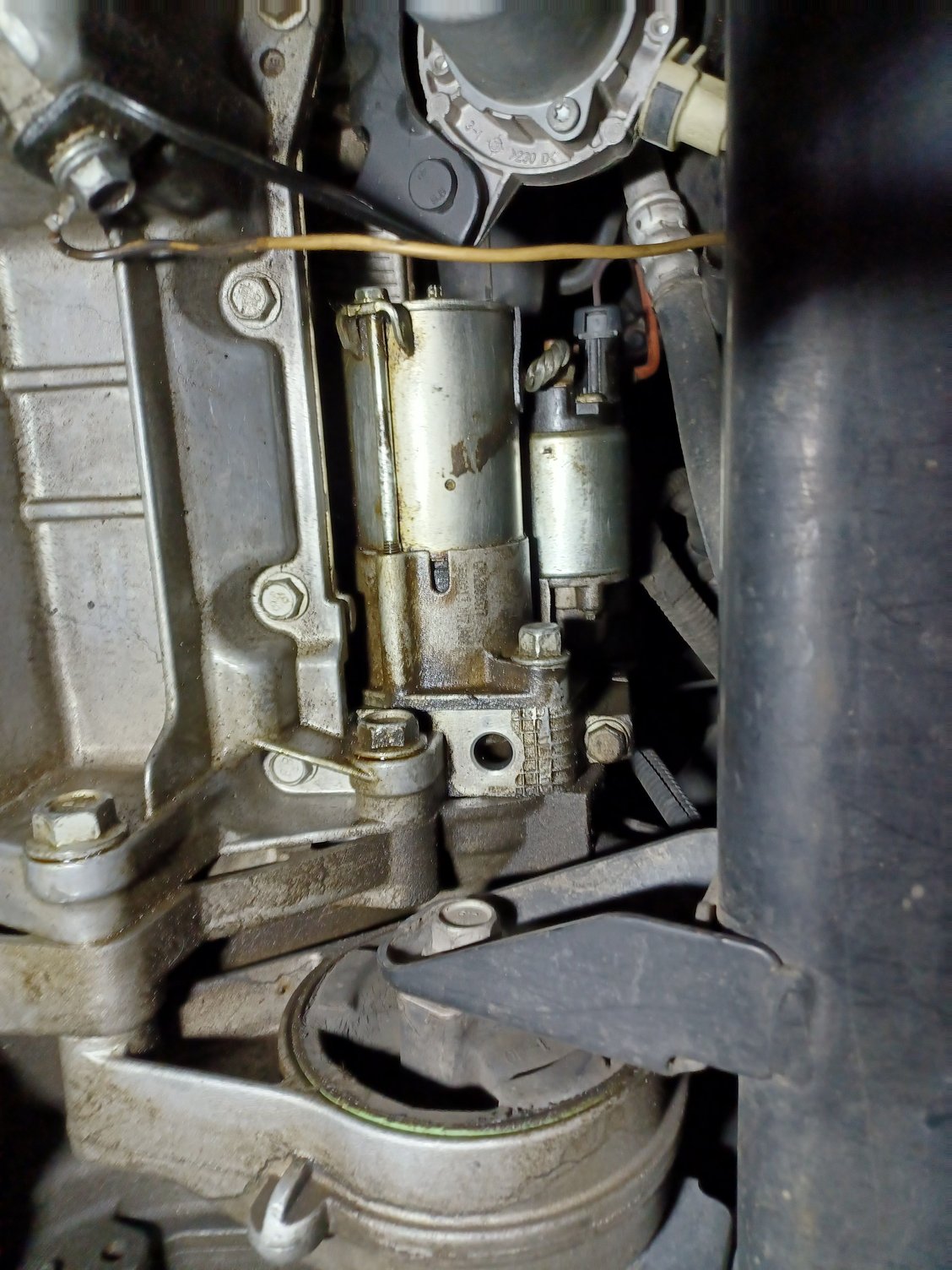

Pics are not the best, it is a little tricky to get good ones.

Last pic. That is the dealer installed vacuum pump for the brakes. Round silver thing and black bracket. If it’s in the way, unbolt it and move it to give you clearance.
Remember !!! Disconnect the battery before working down there. The starter is always “hot”. It connects directly back to the battery.
