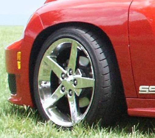

265/35zr18 w/18x8.5 wheels on the front with goldline lowering springs=no rub and great traction. The ride seems okay although I have nothing to compare it to as I put it all together when I had 21 miles on the vehicle.
According to the Tire Size Chart a 265 x 35zr x 18" has a 10.5" Tread Width ! Not sure if you want to go that Wide of a Tire on a 7" Wide Wheel !
