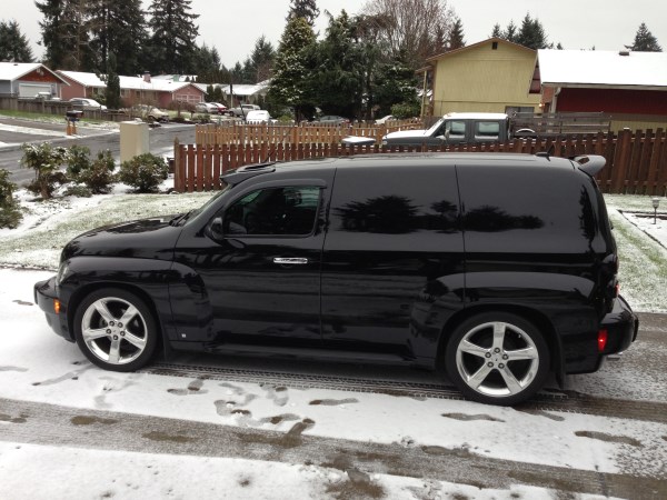

im using it to do auto detailing, and im fixing it up real nice. one thing that is missing is some decent set of rims and tires. i saw a post on my local craigslist and someone is selling chrome hhr 18'' rims, the owner said they belonged to a hhr ss. my question is, can my hhr handle these rims? any help would be great! here's a picture of my hhr

They'll bolt right on, it's an very popular upgrade.
P.S. to the forum!

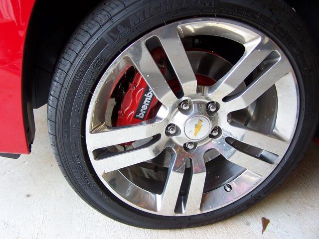

The normal things when buying used rims. Condition: scratches, curb rash etc. Take a good look at the clearcoat for any hazing or peeling, something like that would be costly to get fixed.
Are the lugnuts, centercaps included? Those are different on the SS rims.
Here's a pic of a clean, almost new rim.
Name:  SS wheel and Brembos.jpg

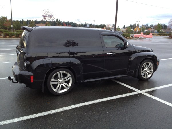

They are polished aluminum, so do they look like these but chrome.
I like 235x45 best but, 245x40 and some 255x40 fit fine. Or you can do what Chevy did 225x45.
