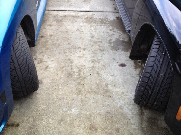

O.K. the weather has been nice. It was about 75 degree around here yesterday so I decided to do a little cleaning and detailing to the ol girl. Here are a few pics of her with her new shoes. I cleaned and painted the rear drums and front disks and calipers. I still need to figure out something for the center caps. Oh, and she does still need a clay bar, polish and wax.
She has 90,500 miles on her and I enjoy her more now than the day I brought her home. Hopefully running boards and one of those fancy leather booted shifters are my next mods.
