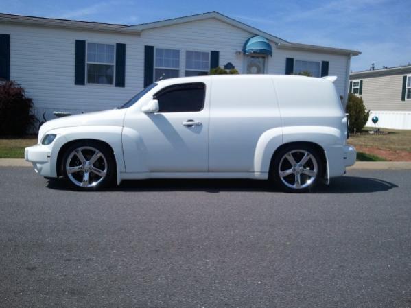

saw this car and bought the same wheels but i wanted to know if i am going to need spacers so i can put them on my hhr??

That is "the Curly 1's" sharp ride..
Yes spacers are needed, but ask "SS Fan'', he has same Solstice rims on his Hot Rod, & can give you all the details etc..
