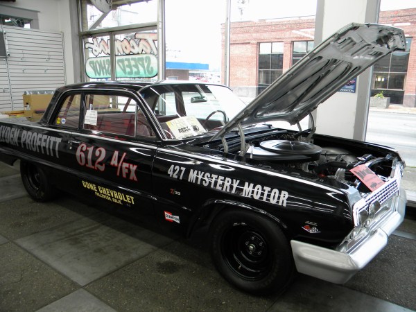

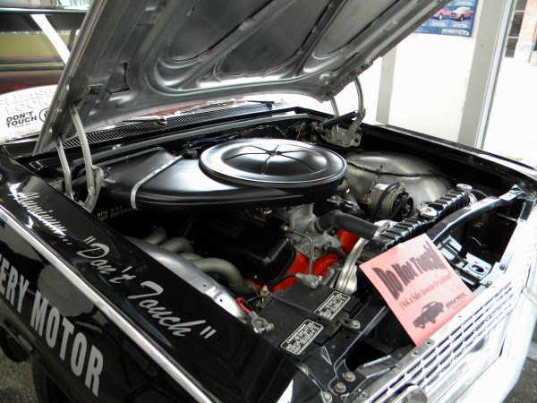

I wanted to complete the project, I wanted to get them, the first guy found them by computer and confirmed them by phone, so I made the run and ended at the shop, was fun to look around there. remember this
