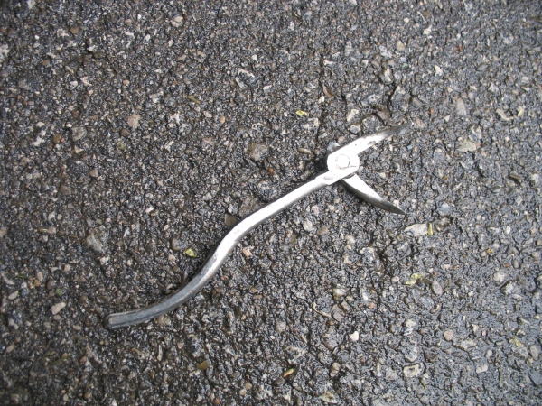

Picked up this awesome pair of pliers last night.

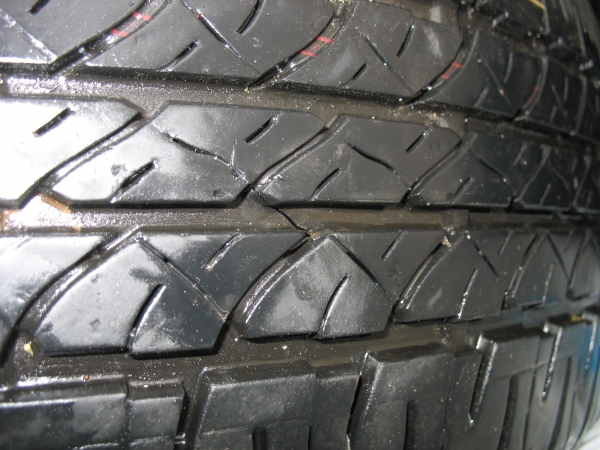

Unfortunately I picked them up off the road, using my rear tire. Heard a bang, then a grinding dragging noise. At first I thought my exhaust had dropped. When I checked it out, found those old pliers stuck through the plastic on my inner fender. They had gotten jammed and opened a nice gash in my tire, about 3/4" long.
Im thinking a gash like this wouldnt be fixable using multiple plugs, so I may try patching it from inside the tire. Anyone have an opinion on patching? I guess my main worry is the tire blowing out on the highway under stress.

Yeah, that tire is a goner. Even if the gash did not penetrate through the carcass, eventually the exposed cords will deteriorate and the tire will fail. For safety's sake it should be replaced since its not a matter of if it will fail, its a matter of when.

Thanks everyone. The fender damage is only the plastic liner, so I will see about sealing up the small hole.
For the tire, I may take it off the rim and inspect the inside to see how badly the belts are torn.
And it leaks alright, loud hissing from escaping air. The soapy water test was fun, spit water all over my face. However, since its a tear instead of a hole, it seals itself enough to hold enough air to travel about 15 minutes after being fully inflated. After it happened, I was able to make it to a service station and pump it up, then made it home and put on one of my snow tires for now.
If this isnt fixable, its just the excuse I need to get a new set of summer performance tires, although I was hoping to put that off for one more season for monetary reasons.
When I owned my station we used a reinforced patch called a "boot" on truck tires for bigger problems like yours. However, I wouldn't recommend it on modern steel radials. Had the cut not gone through to the cord (it has to have, else it wouldn't be leaking) you might get away with a reinforced patch. Sounds like it's time for tires. Oh, and check your comprehensive insurance - some will pay for this since it is caused by a foreign object (less the deductible, of course).
