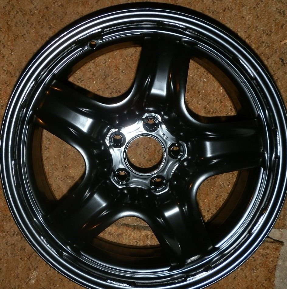

I received the new rim today. I looked it over and it seems fine except that I noticed 10 small pieces of metal around the outer side that look like they are welded on the rim. My old rims don't have this. Is this unusual?
Difference in rims
Old Dec 30, 2022 | 03:51 PM
Posts: 40,088
That’s fine, just a different manufacturer, uses a different welding machine.

Here's a complete photo. I think it was made in Switzerland. I thought it might be for a different car even though the fitment is correct.
Full
Old Dec 30, 2022 | 08:03 PM
Posts: 26,536
Those bumps are for holding wheel covers on. Be really careful that they are the correct bolt circle, I got one that seemed to fit but the studs were just a bit off and the wheel actually broke after a few miles.

Those bumps are beads of weld , the hub cap is held on by the double threaded lug nuts and the plastic nuts.
Old Dec 31, 2022 | 09:56 AM
Posts: 26,536
The original HHR wheel covers are held on with the lugs. The pictured wheel has 10 weld bumps suitable for holding spring clip type wheel covers on. As the OP stated "might be for a different car ".
No other reason for welds in that position. The first pic looked, to my eyes like the inside of the rim, the last pic clearly shows them on the outside edge where nothing is attached, evenly spaced and hopefully of equal weight.
