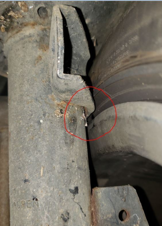

I think they look great and ran across a deal on a set. The guy I bought these from told me they were mounted on his HHR without any spacers. He said they will bolt "right on". So I tried them on the front and the rear. When I mounted them on the front, the tire rubs the strut on the bracket where the stabilizer attaches (see pic below). Did not try turning the steering to see if it would rub anywhere else. It appears the spokes will clear the brake caliper, but it is really close. The rear clears no problems. I think the e-brake cable was the closest thing to the tire
The tires mounted on my Solstice rims are 225/45/R18. I have not verified the offset, but from what I have seen here, I would need 16mm offset spacers and longer studs. The factory HHR studs cross-over to a Dorman 610-324 (M12x1.50 x 34.5mm Lg). If I need 16mm spacers, the studs would also need to be 16mm longer. The closest Dorman stud I could find would be the 610-323 (M12x1.50 x54mm Lg).

Is it just touching the swaybar end link bracket?
Are those aftermarket struts? What brand?

Yes. Its rubbing on the strut. I circled it in the pic. As far as I can tell those are factory struts. The PO said nothing about changing them.
I just measured the rims and they are 54mm offset.

LS rims are 42 mm , so at least a 12 mm difference. Does the strut have 2 mounting holes for the swaybar end link? OEM would have just one.
This KYB has just one tab , they are left or right specific part number
As we see in this Moog photo there is a bracket welded on to the strut
The bracket on mine has two holes. I guess so that it can be used on either side. Fro.m what you are saying I must have aftermarket struts. If the bracket did not wrap around like the "KYB" in your picture, my tire would not rub at all.
Thats probably the difference. I need to replace my struts too, so now might be a good time to do that.

Why is there no end link attached? Is it in the other hole?
Yes. That pic is the driver side looking from the front of the tire toward the rear of the tire. The stabilizer is hidden from view behind the strut.
