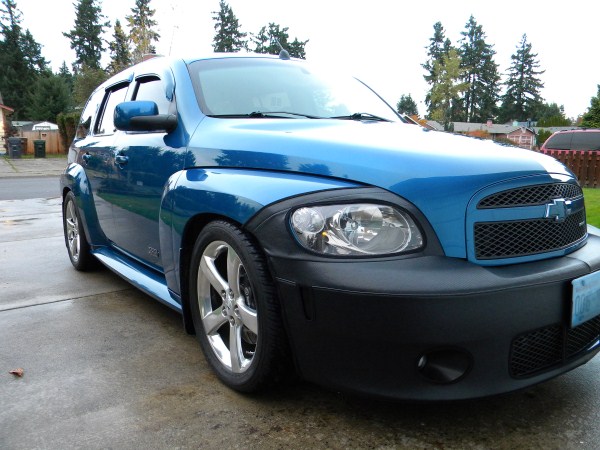

It's not that big a deal, I extended the studs on both, and run H&R spacers (15mm). Never had a problem, and they are the easiest wheels I have ever cleaned......

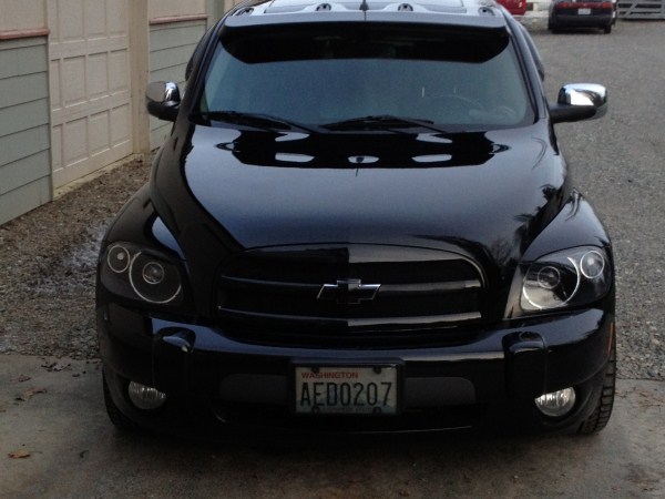

What you didn't see my work horse, this one makes the bacon........
Old Feb 8, 2014 | 09:06 AM
Posts: 39,988
lean and low and shiny black!!! nice display of what Solstice rims can do for your HHR!!
Wow that front end looks great..like the headlights. Thats an awesome looking panel! Thanks for the pics.
