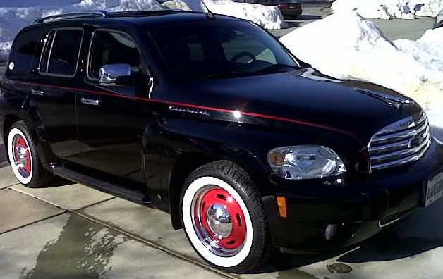

There are 16" rims that fit the HHR. The key for any HHR wheel is matching the bolt pattern which is 5X110. Here is a place that sells smoothies with the baby moons that fit the HHR:
http://www.petepaulsen.com/Catalogof...R%20Wheels.htm
They will powder coat the smoothie for you too ($40 per wheel) charge. I just purchased the rallye wheels and had Pete Paulsen paint them Red:
