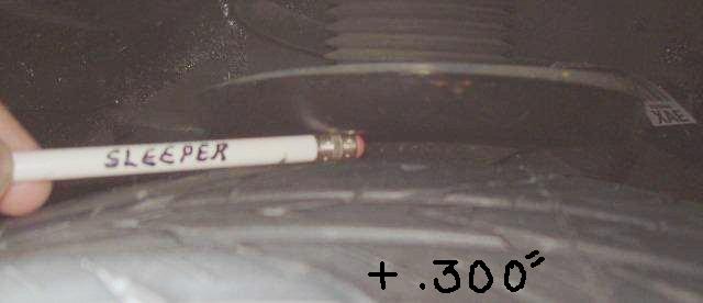

I would not go taller than a 26" tall tire.. Any taller can hit the front strut plate.. (see pic)..
I have 225/50/17s' on in a brand that is 26.1" tall.. & they just fit.

Those Michelins I am contemplating are 26.1 inches high. So, do yours hit that plate if you were to bottom out the strut? I guess I'm asking; do you have any signs of rubbing? I'd hate to negate 90K tires by rubbing away some tread.

Different cars will have different clearances, when I was running the 225/45 18, they were listed as 25.9" and as you can see, I has about as much clearance as Sleeper.
To know if you will clear a 26.1 tire, you should measure. Odds are you will, but that is getting to the point of very close.... If it clears sitting still, it will clear. The strut plate moves with the suspension.
No rubbing issues on mine at all.. Probably over 600 miles on them now.
I did do a lot of careful measuring & was also careful in tire selection.
If I got very "Squared shoulder tires, I do think they would rub the strut plate..
Going this tall, you really need to do your homework, so YOU are sure..
This really is not a one size fits all dealio.........
