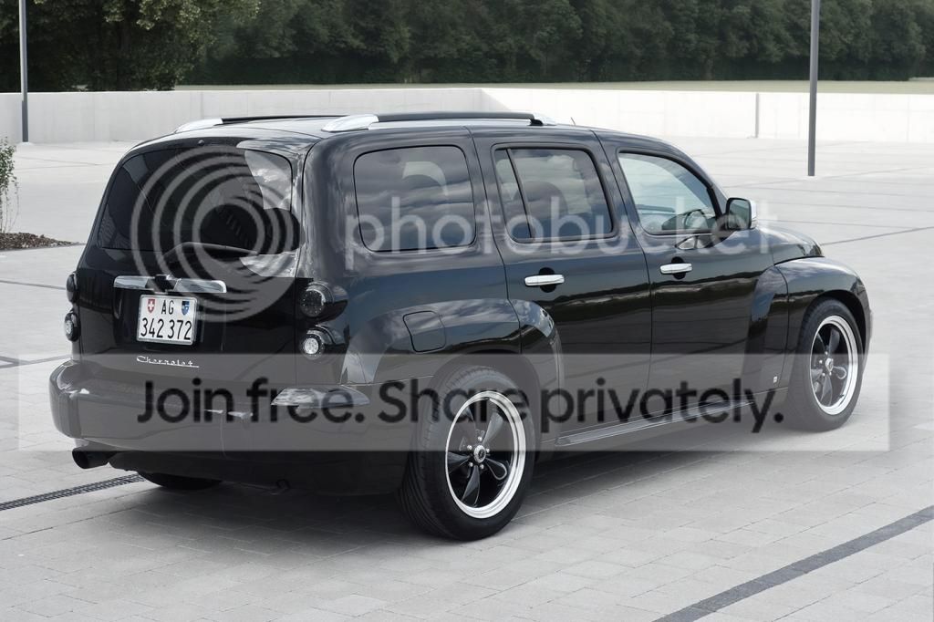

A Member's ride ...

Very sexy but , that is the HHR with the redrilled Mustang rim's he had some machine work done to the back of the centre hub of the wheels and I believe he required spacers so they would clear the front calipers, so not a simple bolt on read the insert in post #8 from JerseyJames about Romeo~Rocks he even mentions centric rings

Yeah,at the time was not a bolt on. Had this done in 3-13-2013. factory probably didn't offer the wheels with HHR pattern at that time. not Mustang bullet - but this - American Racing Torq Thrust M. He had the backs of the wheels machined to that back spacing, along with the redrilled bolt pattern. The centric rings may be a European thing? (he's in Switzerland). Looked back at some of his posts & the bullet wheels were discussed, but he got the Torq Thrusts at the specs in post #8, this thread.
Moot point as at Amazon,
American Racing Torq Thrust M 2008 HHR wheel American Racing Torq Thrust M 2008 HHR wheel
says wheels fits a 2008 HHR ... & at that price may get a set myself!
That being said, ask vendor (if you can) about what if rims don't fit and get it IN WRITING. as they say "caveat emptor" - let the buyer deware
p.s. don't forget to check on lug nuts, do you need different ones to run this rim?
