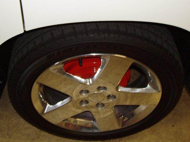

Yes, I'm assuming you had 16"s, quite a diff in sidewall height, (lot less) especially going to as 45 series tire that is 25.4" tall.. That will take away some cushion..
Painted calipers & drums really would make her Pop.. I painted mine with Eastwood's Ceramic Hi Heat Engine paint. Excellent Paint.
