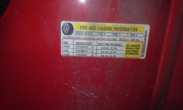

Hello everyone. I have custom 18" wheels on my HHR. recently I hit a pothole in the road and destroyed one of my rims and the tire. I cannot find the rims anywhere online or local. From what I gather, the stock rims on the HHR are 16". I found a decent deal on a set of 15" wheels and was wondering if they will fit. Thanks.

If the bolt pattern is 5X110, If the offset is correct (somewhere around 41mm), if you have standard disc brakes (not Brembo), yes.
Have you looked at the placard on your driver side door frame or looked in your Owners Manual? You won't have to guess about what is standard.

A 2007 would only have the 10.65 front discs so yes 15 inch Malibu rims will fit!
