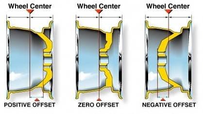

Charles-
I'd say you need to find some with very Positive offset (see pic) to keep the tires under the fenders..
Old Dec 16, 2011 | 01:15 AM
While Dayton doesn't make wheels for the HHR, they do make positive offset rims for the PT Cruiser.
http://www.daytonwheel.com/ptcruiser.html
And you can buy wheel spacers/adapters to get you from the Cruiser's 5 X 100mm bolt pattern to our 5 X 110mm pattern.
http://www.roadkillenterprises.com/5...00-to-5-x-110/
So this would be one option to consider Charles, you would have an offset that is going to end up somewhat "wrong" but if you absolutely have to have wire wheels its one way to go.
