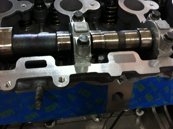

Ok so heres what Im doing. I drilled and tapped for 1/8" NPT in the cover and head. I will use 90 degree fittings pointing towards the front of the engine to mount a catch can using a couple valve cover bolts. In order for this to work you just need to separate the valve cover and head. I am probably just going to use a very thin piece of sheet metal(because easy) and put some RTV on it and bolt the cover on to hold it in place. Or I can weld the head and/or cover shut. Doing this allows you to leave the valve in the stock location. What do you think?

  #115
Posts: 26,533
Wouldn't you have to worry about liquid oil flowing?

Nope just oil vapor in these ports. I actually just cut a small piece of pop can and used rtv and bolted the cover on. Unless I completely overlooked something elementary, I think this should work great.
That port you've blocked off(I'm surprised I didn't look down in there when I had the valve cover off), as long as that's not open on the bottom to the crankcase, looks like a good plan!

No problem... Won't muck up your thread.
That center port only feeds down from the valve cover.
