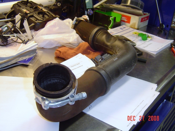

Just got mine done Sat. I like it...I figure around Thurs. or Fri. after it has had time to learn the GM upgrade I'd throw the H/P Tuners back on it and tweak it some more....I agree with the others maybe something like the aircharge intake hose is loose or not installed correctly....maybe cracked now it's been known to happen....As you can see it's a rubber hose to plastic to rubber again... How much boost will this really hold?
