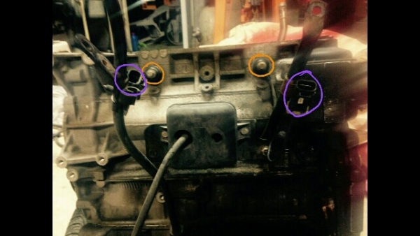

Now if we want to check your knock sensor connection that's easy peasy! Almost, lol. They are both located under the intake manifold. The hardest thing about getting to them is you'll probably need to disconnect the upper radiator hose and the top radiator mounts. You shouldn't lose much coolant if any. If you can get your hands in there you might not even need to move the radiator.
The radiator will pull forward almost 4" so you can look in and get your hands in there. If you need 8" there is 1x 10mm bolt holding your coolant overflow bottle in place. If you want to go that route, disconnect it from upper hose and yank it outta there. Now take a big sharpie and make a big line for the FULL level! Great 1 project done (lol, that was just for fun) The wife is out in the garage getting pics of the sensors as I write this. So pics soon.
But with the radiator pulled back you can probably see both knock sensors or at least their connectors. The connectors are pretty easy to get at. 1 is mounted to the dipstick about halfway down. The other is mounted to the support bracket that runs from the front of the intake to the block.
I'm not sure if you're aware but your new motor came with new knock sensors. Also, if they aren't properly connected I'd be hollering at that dealer of yours!
Pics 2 follow, it is nice to have a "reference" motor in the garage. Plus a wife, who knows where to find a knock sensor! LoL
Sensors are in orange, connectors are PURPLE
