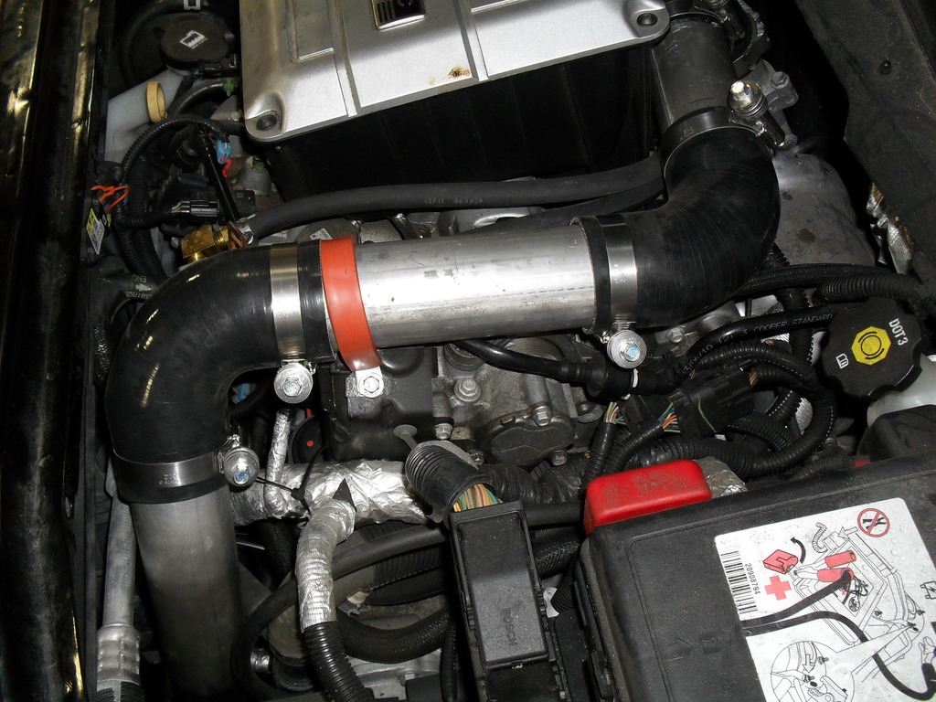

I just installed my DIY IC pipe

Hey Cat Man
can you show a pic of the lower connection, to the intercooler? or did you use the stock connector on the bottom end? just curious as i hate the stock plastic pipe! thanks

Originally Posted by paperboy72
Hey Cat Man
can you show a pic of the lower connection, to the inter cooler? or did you use the stock connector on the bottom end? just curious as i hate the stock plastic pipe! thanks
I left the stock OEM rubber hose on the inter cooler. The tube that is clamped to that is a 2 1/2" exhaust pipe with a 45* bend. One leg of it is about 13" and the other leg is 4".
I bought two 90* silicone elbows from here. Click on the image to see the full page.
http://www.ebay.com/itm/331558147268?_trksid=p2060353.m2749.l2649&ssPageName=STRK%3AMEBIDX%3AITThe two straight sections of pipe are 7" and 11"
Also using constant torque hose clamps, no need for T-Bolt clamps. They work on IC pipe for Cat truck engines, so this application should not be a problem.
Old Apr 4, 2016 | 09:48 PM
Posts: 40,083
You might want to double check the pipe right next to that A/C line, the look like their fixing to be kissing cousins!
Nice looking pipes maybe in the summer buff them with some 0000 steel wool and clear coat them or maybe gloss black paint
After I took this picture I moved the pipe location, all is good. I'm going to get a longer M6 bolt then I have now and add a longer spacer from the one that's there under the tubing clamp to raise it up to give more clearance to the lines under it.
Was thinking of replacing the 2 90* elbows with steel and welding back together then crinkle coat it.
That lower connection is not user friendly for one person to install the pipe. I left the hose connected to the IC and slid the pipe onto it. Went under the car and squeezed my hand up to hold the hose clamp in place and used a long (18") 1/4" extension and a 3/8"" universal socket to tighten it.
Old Apr 5, 2016 | 07:14 AM
Posts: 26,532
That sounds like bloody knuckles!
I can tell it is. If the bumper cover is off it's a bit easier.
