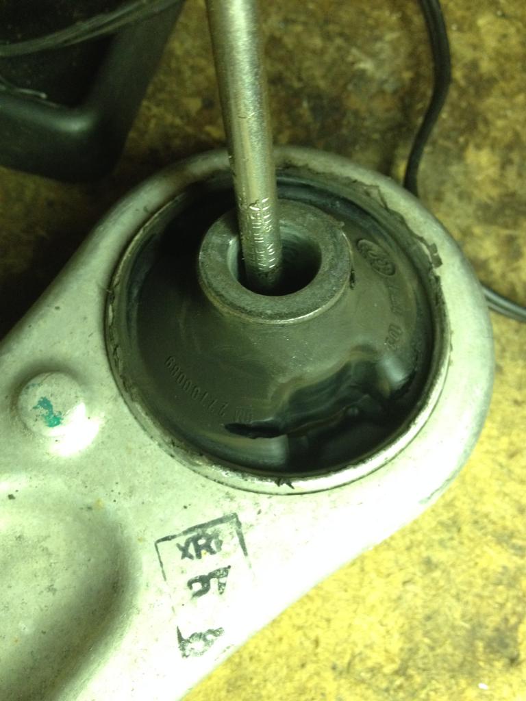

I do plan on getting slicks however that will have to wait till next season as I wanted to upgrade everything possible to make launching more efficient and consistent before slicks. Control arm bushings will be done tonight. Here is a pic of the passenger side CAB. See how it is already starting to tear, and my car only has 23k miles! 20k miles of which were tuned to 330-350 ft-lbs & 300-330 whp.
