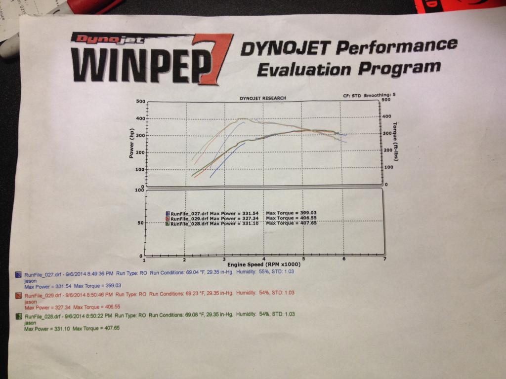

Got er strapped into the dyno again after the update: 331HP 407TQ
This was at a local street racing event(legal). Pro tree 1/8 mile, stop light drags, and roll racing. I'm happy to say I went undefeated in roll racing.
Here are the victims:
Early 90s ford thunderbird- no competition
Late 90s pontiac Grand Prix GTP. Fully bolted and tuned makes 325 whp
Chrysler 300 with a procharged & intercooler Hemi V8
2011 Subaru STI hatchback, fully tuned, and some other unknown mods(best race of the night for me, very close and I came from behind for the win)
Hit a new best 1/8 mile time of 8.91 @ 86 MPH with a 2.3 60ft. I need slicks bad. No street tire can handle the vicious spool of our K04 on E47.
Old Sep 7, 2014 | 02:16 PM
  #34
2005HHRauto's Avatar
Joined: 04-26-2009
Posts: 669
From: City of Champions
AWESOME...
A good E47 'tune' , will always put you over 400 TQ , A buggy on steroids...
Vince did you right…
It's always hard, trying to tell guys, that E47 makes our buggys a torque monster...
Yea, 400 TQ , with wrong-wheel-drive, SUCKS...
Slicks + 400 TQ = 12's...

Yea he did. But, I believe all the detailed info I provided him(drag logs, street logs, and dyno graphs along with my own evaluation of the performance) helped him figure out what the car needed and what I expected. Torque management is still a problem though. The track was so sticky in the beginning of the night, I was able to just drop the clutch(slipping it ever so slightly) and it would hook then bog down. If it didn't bog on those first couple runs I probably would've gained at least .2 of a second. I hope he is able to remove it completely so i can manage my own damn torque with the pedals lol. Here is a video of the 331hp/407tq run:
