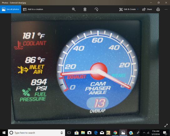

Posts: 11,719
All 2010 SS's have the RPD unit on the dash so, since the OP has a 2010, you can monitor the actuator valves to see if they are working. Just turn the screen selector on the RPD to the "cam phaser" gauge.
If the intake or exhaust actuators are working they will show on the screen. Not working the gauge will not register and be on "0".
(I'll see if I can find a picture )
Working
Intake side not working. On mine it would get a P0010 code.
Working
