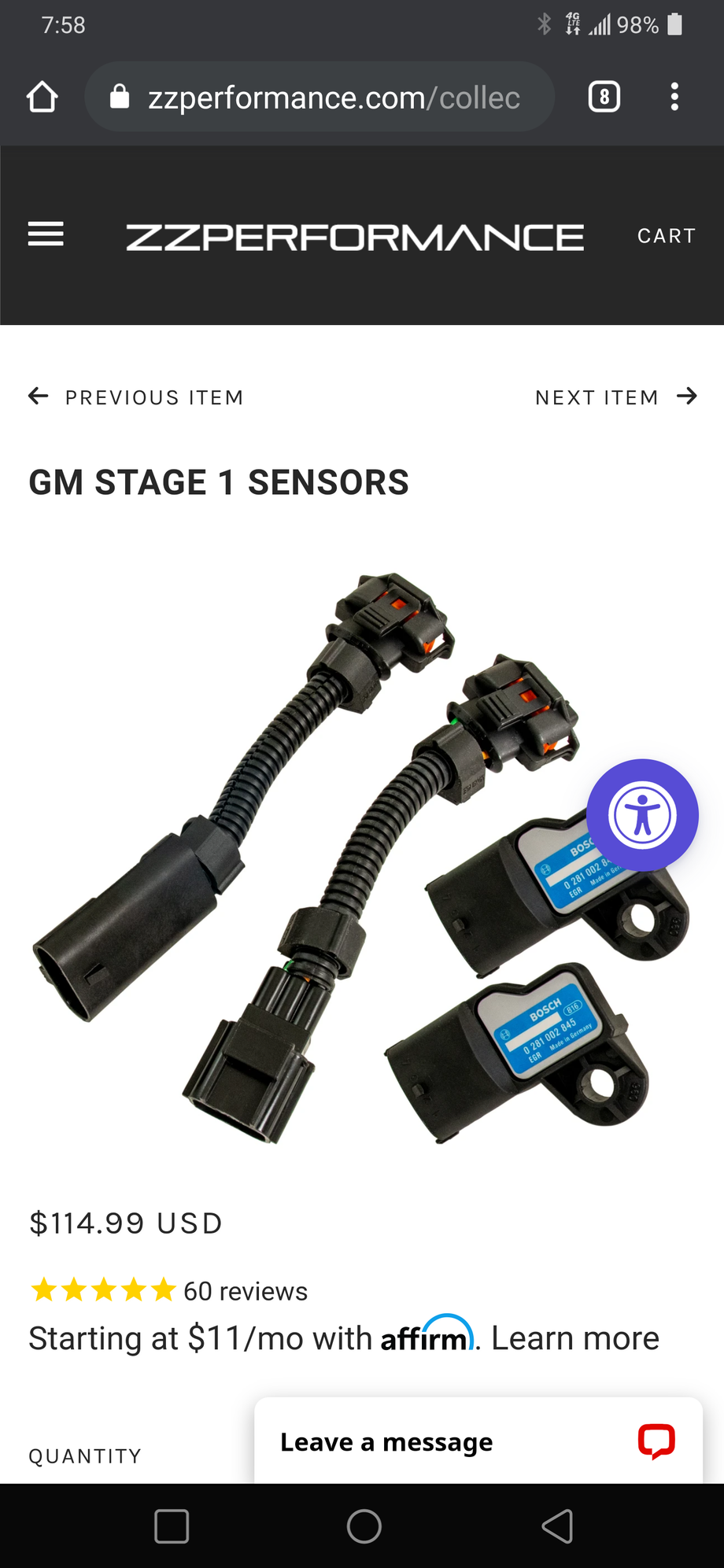

I changed out both. The kit came with both top and bottom MAP sensor. I also sent in my PCM to get retuned. It work fine until now. The sensor came with the plug in play adaptors so no splicing was needed. Are you saying the top sensor or the bottom sensor might be touching the ac compressor? I hope its not the turbo causing this power loss.

FYI. There is no such thing as a Stage 2 sensor for the LNF engine in the SS. Only thing that was offered as far as stage kits was the GMTU (GM Turbo Upgrade) or as it is called a Stage 1.
You're right. I thought it said stage 2 for some reason.
These are the ones I installed.
